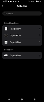

The first thing i had to do, was to add the Hub “Hub 200” to my Tapo devices
 For the initial setup you need to use an ethernet cable connected to your router to get the hub registered, afterwards you have an option to connect it to your wifi network so that you can place the hub somewhere else (but it will still need a power supply)

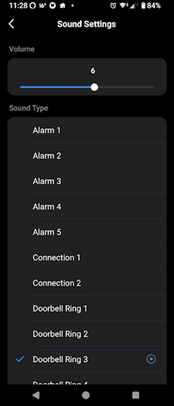

Plenty of doorbell chimes and the volume of them on the hub can be configured here, as well as the length.
I was able to place my hub like this so the doorbell chime could be heard better upstairs, the maximum volume is 100 dB.

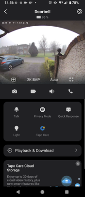

Option to interact with the camera. (Phone in landscape mode)
Where you can take a screengrab, record an interaction, enable the microphone, or have a voicecall with the person outside.

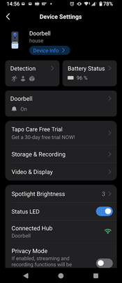

 Main Device Setting Menu, where you can select
Detection
In Detection you can select from the below options , where you can select the area where you wish to monitor also another option for Package Detection
 Having the detection area is a handy feature as if you have an area of movement that you don't care about like cars driving by, or a footpath across from your home you have that outside the area of detection so you wont get notifications.
