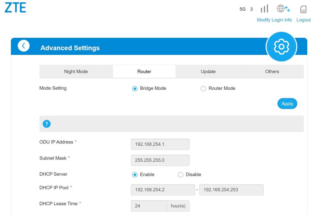

hey. you didnt mention what hardware you have. in case you have outdoor antenna which connects via network cable to a separate router try this:
If you're the only user on that connection try if you can connect to your VPN without the router. in order to do that you need to change the modem from 'bridged mode' to 'router mode' in settings.
screenshot below is for the outdoor antenna ZTE T3000
the default user name for the outdoor unit is "user" + the password on the stickers you got
in case you can connect to your VPN without the router try a hard reset to ...reset factory settings.
Hey Soeren, thanks for your advice. I used ZTE router. In any cases, factory reset helped to resolve this issue.
