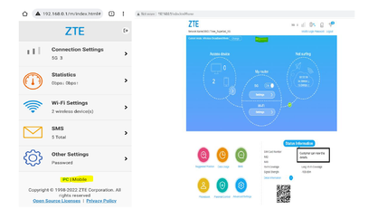

Accessing the ZTE dashboard
Access your dashboard by clicking here: http://192.168.18.1/index.html#login.
You will find your unique dashboard password on the bottom of the hub. Launch the dashboard from any device connected to the hub, enter the URL and password, and then select 'login'. For you information, there are two separate views of the dashboard via your MOBILE and your PC/LAPTOP.
Why do you need access to the dashboard?
  • Change the name of the hub from Three_ZTE to something of your own choosing.
  • Change the Wi-Fi password, just because you want to, or when you have forgotten it.
  • Access the Parental Control Panel, where to can add a 'Kids device' and set time limits on it.
  • Check for device updates under Advance Settings > Update > Check.
  • You can even do a self-diagnostics test.
  • Check your data usage, but you do have to enable your plan allowance. My3 will show your data usage in relation to your billing cycle.
  • See any SMS sent to your device, such as Three+ notifications.
  • Suggested position feature, for when you want to compare window ledges!

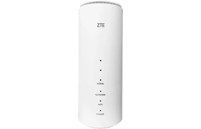

What do the lights mean?
MC801A & MC7010
Signal: This indicates the strength of your signal connection.
Network: Red – The device is not connected to the network.
                Blue – The device is connected to 3G/4G.
                White – The device is connected to 5G.
Wi-Fi: Wi-Fi is on/off indicator (Click here for step-by-step guidelines.)
Power: Off and on indicator.
