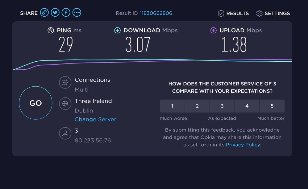

3G speeds are slow, but maybe not bad for 3G. The settings from my router are:
CELL_ID   47215996
RSSI        -83dBm
RSCP      -93dBm
ECIO       -10dB
PLMN      27202
The RSCP and ECIO seem to be low, but probably not bad for 3G. Here's a 3G speedtest:

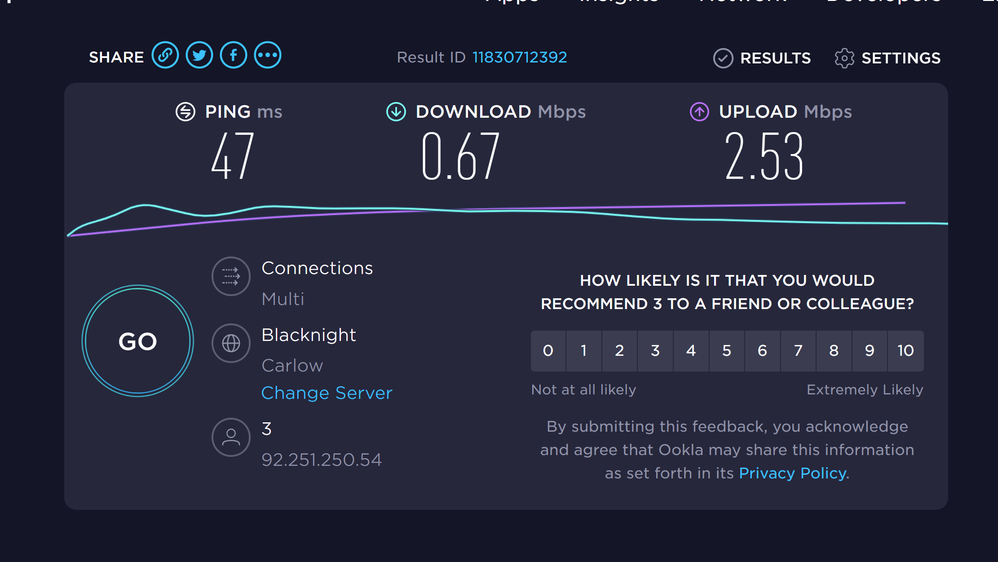

I didn't get a chance to grab a speed test for it since it then dropped to 1Mbps:
CELL_ID   478485
RSRQ      -12.0dB
RSRP      -102dBm
SINR        0dB
PLMN      27205
Here's the speedtest from this one:
The two sets of 4G data above were taken within a few minutes of each other, and while the RSRP is terrible, it looks like the signal to noise ratio SINR is the main variable factor between 5Mbps and 1Mbps and it decreased a lot within about 5 minutes.

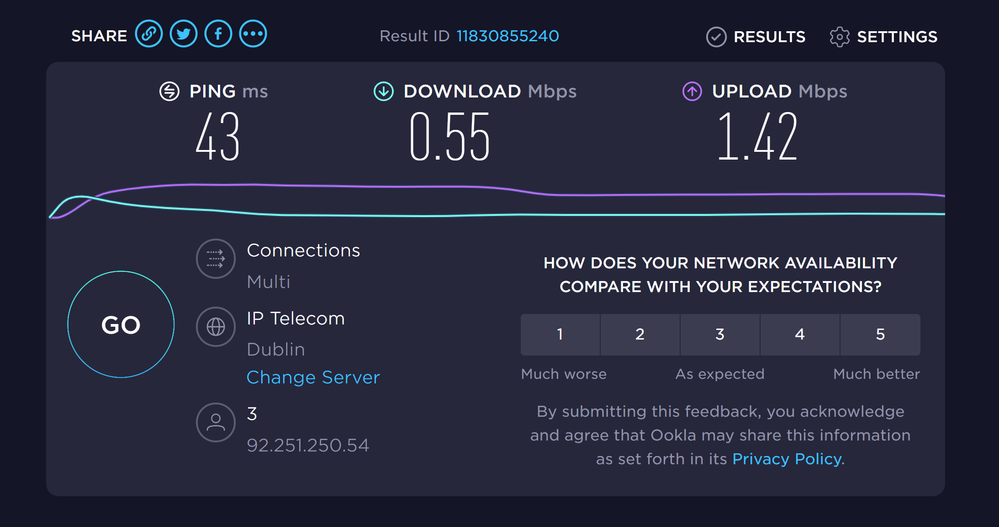

Basically the signal to noise ratio (SINR) dropped a full 11dBm in about 30 minutes (6:50pm-7:20pm) since I started writing this reply. And signal quality (RSRQ) is dropping off steadily too.
Here's the speed test now, worse again, and pretty much what I'm getting most of the time:
