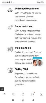

Any update on this ? I signed up last month , as it is advertised as suitable for gaming . Clearly it is not .
I didn't even realise that was part of the advertisement! If so, it'd be grounds to terminate the contract early and demand a refund. It's a shame but after half a year of radio silence from Three, I have lost hope that they'll ever restore the service to its former quality.
From there website
Yeah, you definitely can't consider gaming needs "covered" with strict NAT.
