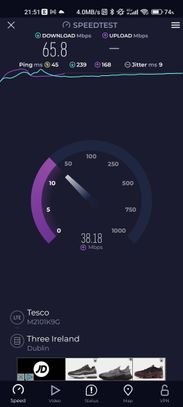

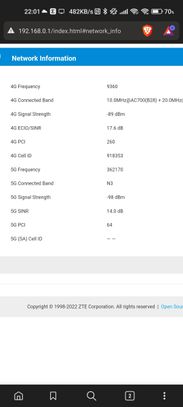

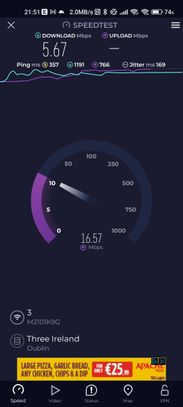

Hi, i have problem with my three broadband. In the evenings, between 8 to 11pm connection is baerly usable. During the day is fast, and super fast in the nights and early mornings, i have no problems to reach over 200mbits. I am about 8km from two masts. I discovered that signal quality drops in the evenings, from 23 to 13-15db.i have zte mc801a hub installed in the attic, against the roof.
Is there anything i can do to improve stability of connection in the evening?.Yours 4g is always fast, regardless of the time of the day,but is not as good for online gaming due to higher pings than 5g

Quality of my connection during the day is brilliant, this morning i had over 200mbits down and 50up. Just the evenings are a problem, speeds goes down as well a signal strength, from 23db to 13-15.

I can't really take my zte modem from attic as its the only one spot im getting full 5g signal. All what im asking is why my speeds drops drastically between certain hours of the day. I understand there is a congestion, but 4g stays on nearly the same speeds all day
