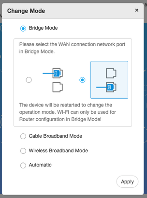

Hi Stacey,
Thank you for your reply.
  • Log in to the router (I can log into the router no problem there)
  • Switch off the wifi (I can't see where to do this, perhaps do you mean switch off the mobile data? when I do the change tab is accessible)
  • Click 'Change' top left
  • Select Bridge (I check the box for Bridge, no problem there)
I don't see any of the following options:
  • Custom DNS (what does this mean?)
  • 4G / 5G SA / 5G NSA Selection (what does this mean?)
  • APN Add/Edit (what does this mean?)
  • External antenna (what does this mean?)
 See screenshot.  
@Kenny_63267 Thanks for sending the screenshot. As the setting sequence is not available for you I would recommend that you contact the manufacturer. They will be able to advise of the steps required to connect.
