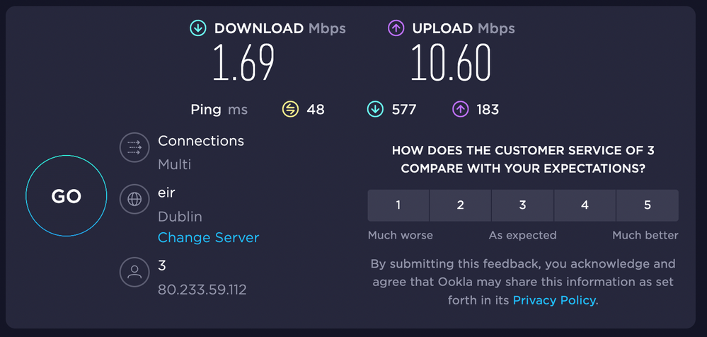

just for clarity : the fault is very much there : we have now I think there is no questions around this, and working from home is impacted as well - the people we have spoken to do realise that - which is why i am certainly not agreeing for me to have to pay for you to fix it.
Here's a speedtest i did just now with my macbook air, which has wifi 6, like the lovely router you give us, on wifi 6 as well .
Imagine. 1.69 download. we NEVER had this on 4g with our old Huawei router.
So here it is. Of course i'd happily have an engineer here. Absolutely i can have a sim card changed. hell, i'll change it myself . But i will absolutely not pay for this visit. not in a million years.
