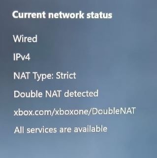

I replaced zte mc801a with zyxel NR5103E. Much more options, band locking, full use of external antennas etc. Still have double Nat too, but it not colliding with anything honestly. I play both PC and Xbox and everything is fine apart from message. Only issue I had was painful slow downloads on Xbox app on PC, restarting teredo solved it. To be honest it's only Microsoft who have problems with double nat

I have something interesting for you all. I think problem is not with ports,but with ipv6 being on  in settings. I have two routers ,zyxel nr5103e in attic acting as a modem and old huawei b535 downstairs to spread WiFi and LAN.
Now ,when both of them working on separate networks,connected via WAN port in Huawei everything works fine,have strict and double nat message but all games works online just fine .Huawei push ipv6 next to ipv4 ip address towards xbox,but in same time it is opening 3074 teredo port automatically which translates ipv6 to ipv4 and everything works fine.
When B535 acts as access point without dhcp its pushing IPv6 towards all devices,my android boxes working fine,wifi on phone works fine,BUT PC with Windows and Xbox wont connect to interenet,even when network is present. In windows its enough to uncheck IPv6 in adapter settings and its good to go.I did play some forza on xbox app and everything was fine ,windows app and xbox uses same 3074 teredo port to connect. In One X there is no option to disable it ,so it was offline all the time.
Now finally when i connected my One X directly to Zyxel with DEFAULT settings (ipv6 on,NAT and upnp off) it went online ,but NAT was strict and UpNp not successful .But,when IPv6 is DISABLED and nat and upnp on without opening any additional ports it connects just fine .So i thing once ipv6 is on ports wont open as xbox as default use this protocol . When you set your router to ipv4 teredo have job to translate it to ipv4 . Three network dont support ipv6 as far as i can see.
Hope it helps 😄
