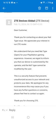

I also have a 4G one for work, THis is also the same. So please dont say its an issue with the ZTE. This is a carrier issue. NAT has been enabled on the carrier side. And its breaking.

 det this from factory is three5G problem not router!
